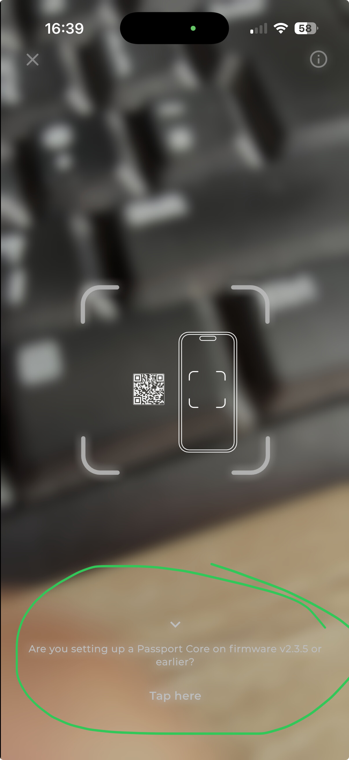

Can you go back to the start of the onboarding on both devices, and when the QR code scanner opens on Envoy, tap the small arrow at the bottom of the screen then tap this text. It will launch the older style onboarding that gives a slightly different QR code format that should unblock you and allow the device to pass the security check.

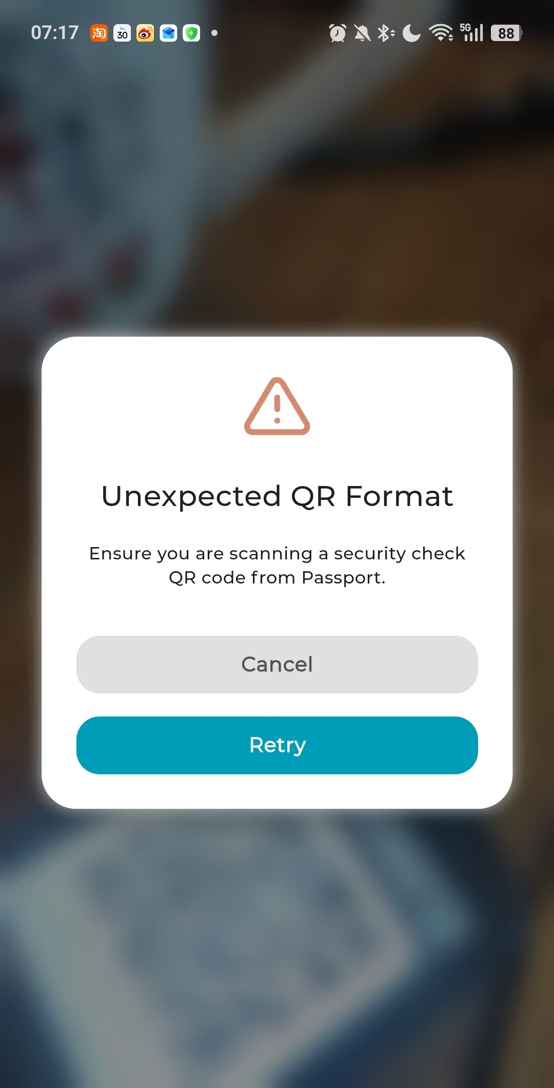

i Still get the same otification.
Hey @pieter, just double checking - you are not scanning the QR code that shows when you go to connect wllet → Envoy, correct?
The screenshot you sent usually shows when Envoy expects a supply chain verification code, and you display some other QR code, like a “Pair to Envoy” QR code That pop up also says nothing about tampering, did you get this message elsewhere?
