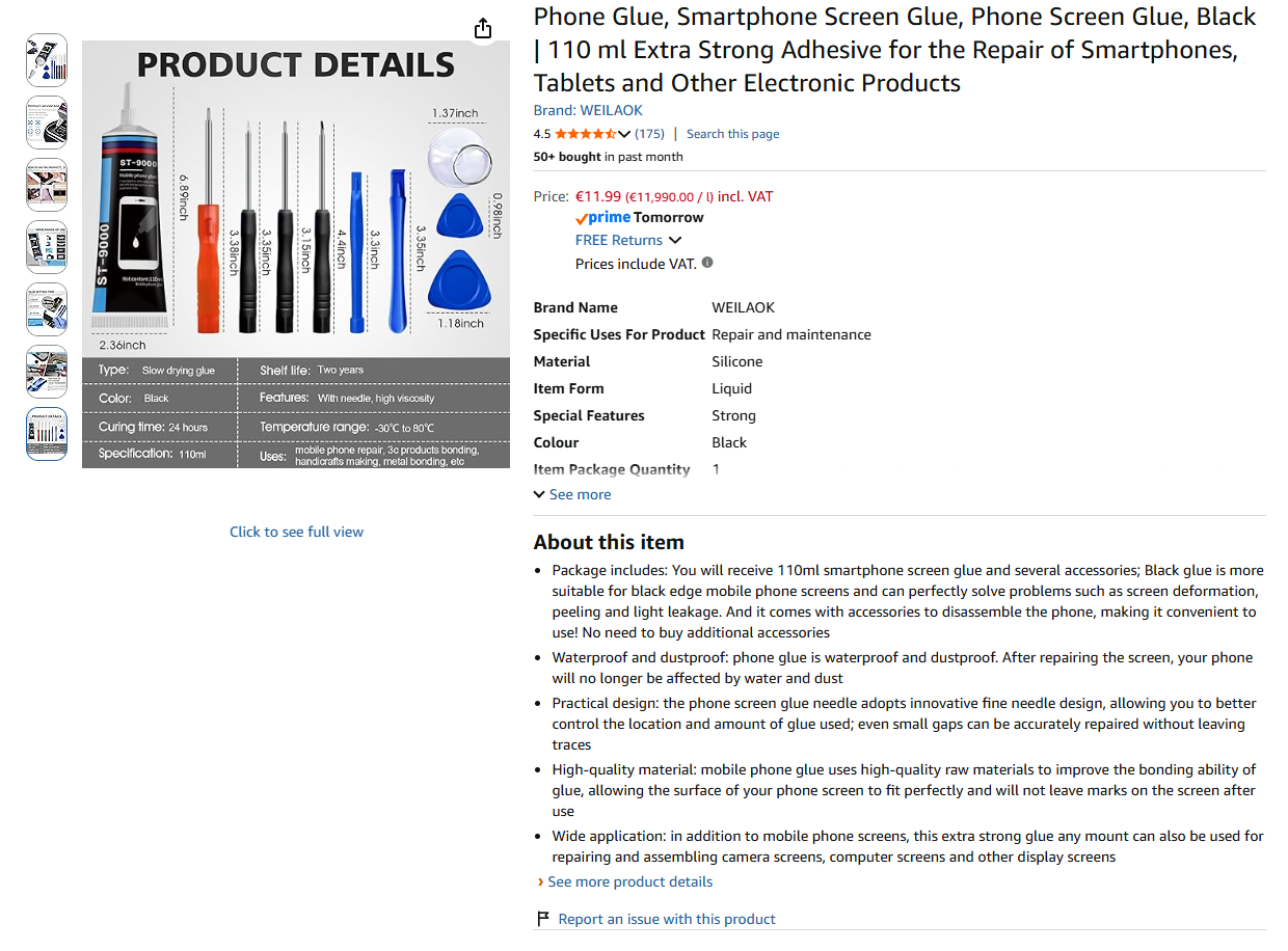

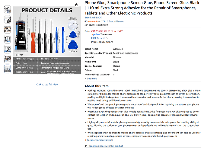

On my end I found a product on Amazon, aimed more at smartphone repair: a black silicone glue, ST-9000 type, full cure time of 24h, high viscosity, temperature range -30°C to 80°C.
Would this type of glue work as a replacement for the DOWSIL for the Passport Prime?
