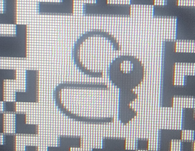

On the QR code scanning, do you guys have any screen protectors or anything on? I’m also curious if the services you had issues with have any custom QR formatting with extra data inside or stuff like company branding inside the QR code that might be throwing Prime off.
This is from Gemini -
Interesting thank you! I’m going to see if anyone on the team has a Gemini account to test on our side, but I just signed up to Optery and was unable to scan in dark mode, but it worked instantly in light mode.

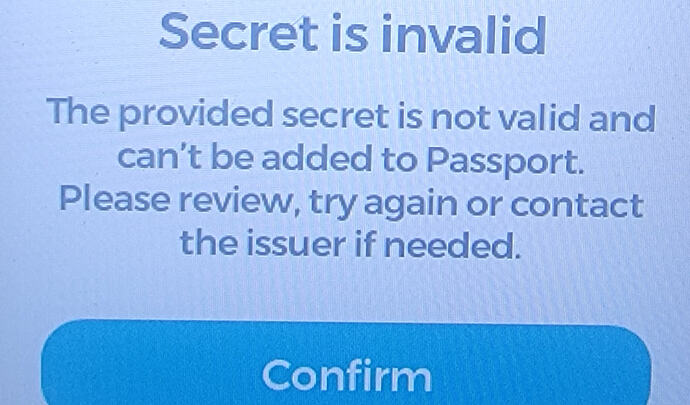

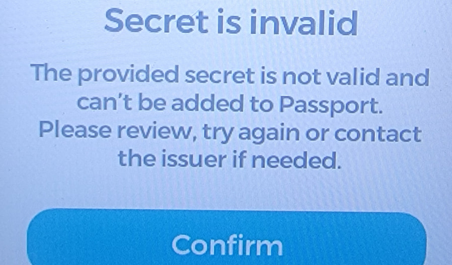

I have struggled with scanning QR codes. OTP Auth is the 2FA app that I use (QR appears unadorned), and I have attempted to scan from iPhone, iPad, laptop, and 2 different external displays (dark and light modes, no screen protectors). None are recognized by the Prime camera (camera is working, but not acknowledging that a code is within the field of view). Prime firmware 1.2.0
Loading the code into Google Authenticator, and then letting Prime scan the Google code results in “Secret is invalid” error.

Useful data points, thank you @Brewse.
  • We have shipped a minor fix in v1.2.1 (available now) that will help with some 2FA services using additional formatting containing :
  • We have much bigger improvements coming in v.1.3.0 that fix imports Google and use new QR code libraries to expand scanning functionality in general
