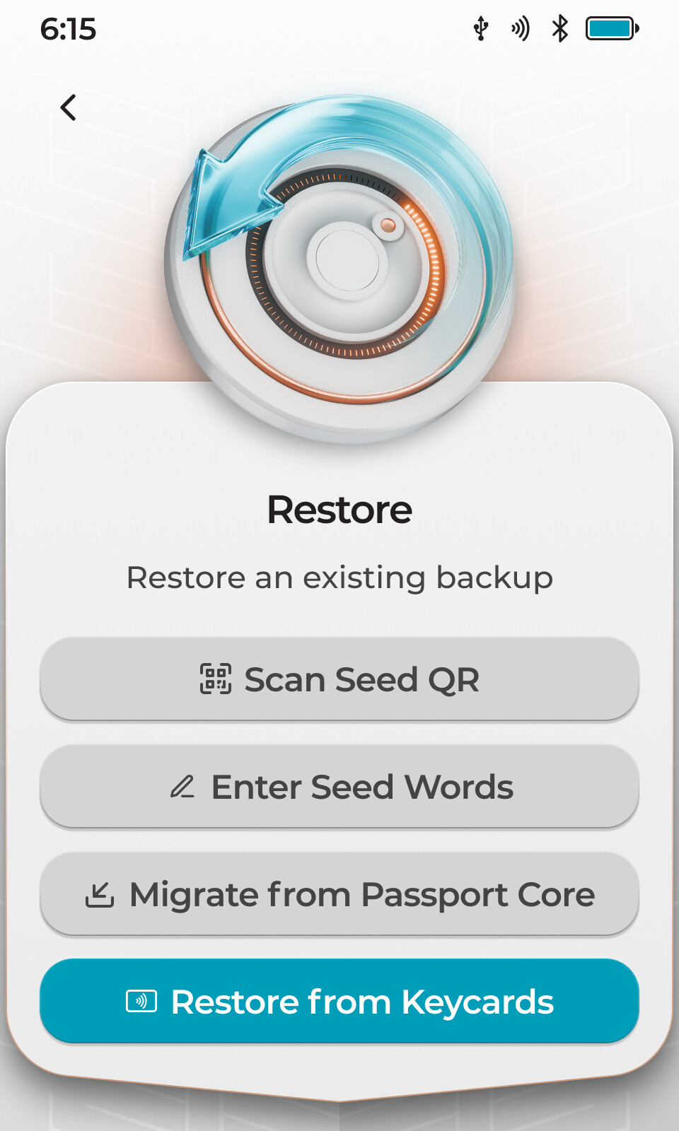

Yes, the recovery flow of a Passport Prime is agnostic of the method used to recover the seed. You can use the keycards, enter seedwords or scan a seedQR (importing from a passport core backup is not available as of right now). When the seed is loaded, Passport Prime will hash it locally and send this hash to Envoy to bounce it to foundation servers, there we will try to find a blob matching this random string (the hash of your seed), and forward it to the requesting Envoy, which in turn will bounce it back to Passport and this will be able to decrypt it locally using the actual seed words.
During onboarding if you tap Restore you will be shown this:
