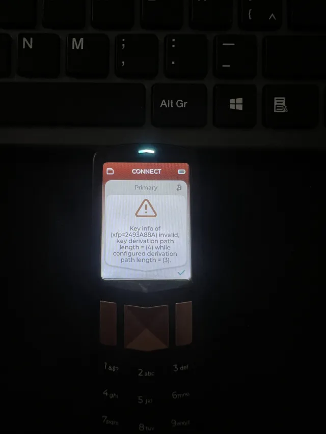

The error displayed on your Foundation Devices Passport device indicates a problem importing an extended public key for a multisig wallet: “Key info of (xpub-2493A88BA1) invalid, key derivation path length = 4 while configured path length = 3”.
Hey,
We’ll need some more info on the setup to be able to assist. Probably better that you contact support directly so you don’t have to share the info publicly here. We’d be interested in things like:
- What software is being used to coordinate the setup?
- What other signers are involved?
- What is the setup quorum (eg 2-of-3)
- What software version are you running on the Passport Core?
- Do any of the other signers give errors when importing the config?
Thanks
- Sparrow
- Yes, i setup a partner tpub. (testnet)
- 2-2
- Last version
- He didnt try
I setup the 2-2 on nunchuk and there was no problems…
Interesting! So just to clarify your Passport did not show the same error when importing the config for the exact same wallet?
Not really, i create a new hot wallet + passport. I guess that my partner tpub was the problem.
Also i imported the descriptor on sparrow and create a tx there. Thanks for your attention.
