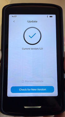

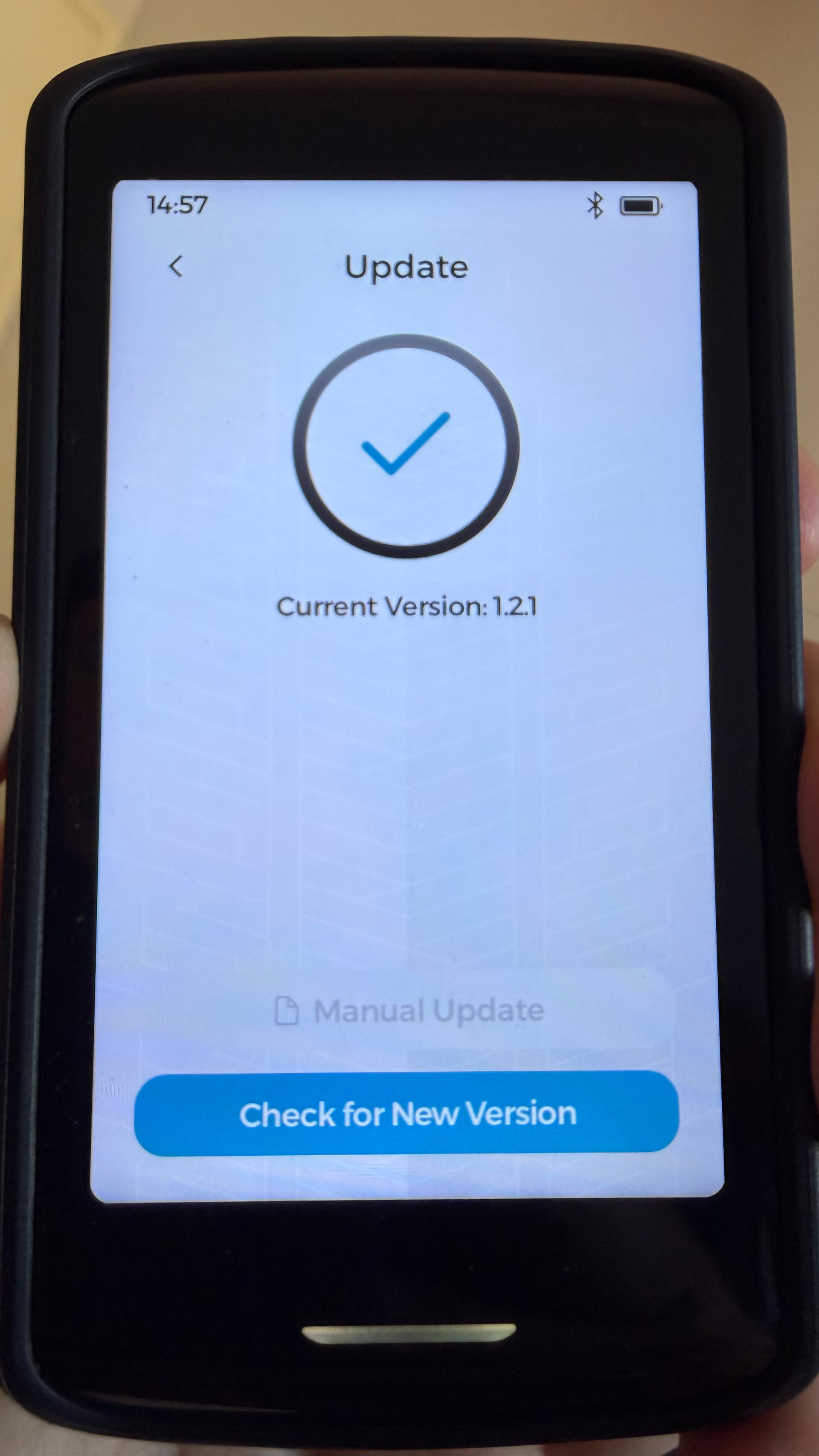

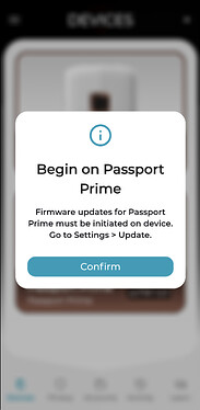

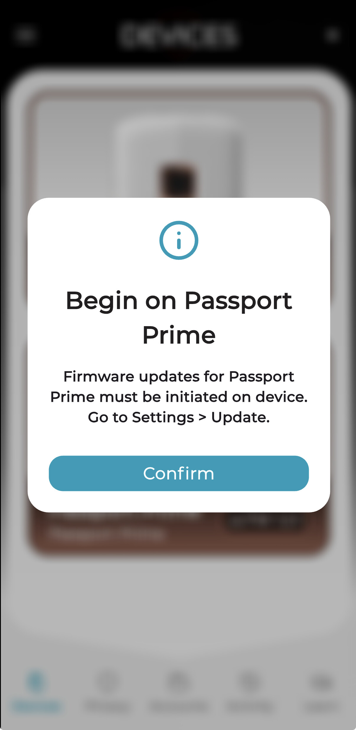

But now I see that there was new firmware released the other day. I have my prime linked to Envoy on my iPhone 17 pro. It shows my device connected but I am unable to update. I am currently on 1.2.1
I check for new version and I get nothing

@DAG this is very likely a Tor connection issue. Disable it in Envoy and try the update check again.
I just went ahead and started from scratch. Unfortunately, ever since I got my iPhone 17 Pro, I have never been able to connect to my own server via Tor. Never had a problem before. Ben has been working diligently with me. I hope to have a solution soon. Not being able to connect to my own node is deal breaker for me. I can connect to my node via Tor on Sparrow. So it’s definitely something on the Envoy side
