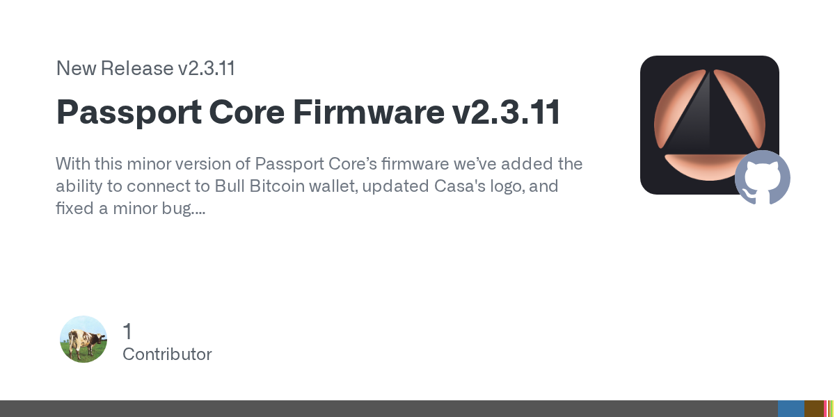

its been two years since your last update for core. what is going on here???
Our last release was 8 months ago.
v2.4 is scheduled to drop in the next 4-6 weeks.
i have a number thats higher than this so how is this possible?
Can you explain further? I’m not sure what you mean.
In release versions, 1.5 does not mean 1.50, nor it means 1.500 or 1.50000.
When you start building software you don’t plan ahead how many verisons you will have. We could do 1.05, but then what happens if you get to 99 releases. So we do just numbers, think of them as integers separated by a dot, not decimal system.
1.5 is bigger than 1.11 in the regular decimal system.
1.5 is smaller than 1.11 in software releases, because 5 is smaller than 11
