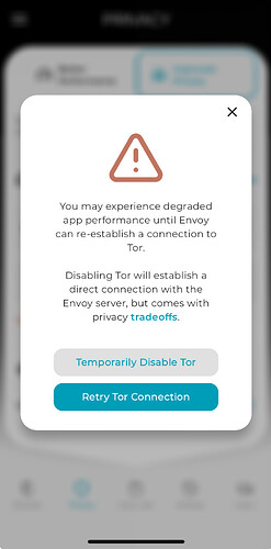

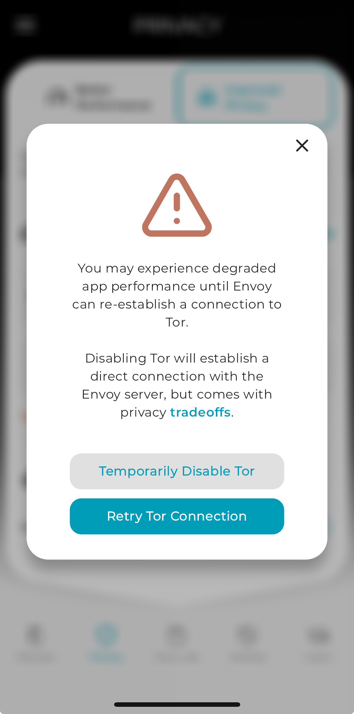

I’ve been having trouble connecting to the Tor network lately and just wanted to check: is it just me, or are others experiencing issues too?
Would appreciate any input or confirmation. Thanks!
Have seen one or two customers. Perhaps you could share more details to see if anyone else having the problem can find similarities. Eg phone make and model, connection type (cell/wifi/both), Envoy version and Envoy logs.

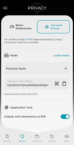

I’m using an iPhone 16, Passport Batch 2, and the Envoy app version 1.8.6.
I’ve already tried connecting via the Foundation node (default) and also using my personal node (tcp://otz3####e7qd.onion:50001), but neither worked, whether on Wi-Fi or mobile data.
I even tried using Orbot, but that didn’t help either.
Have you tried on both cell and wifi connections?
Neither worked — I tested both Wi-Fi and mobile data, no success.
