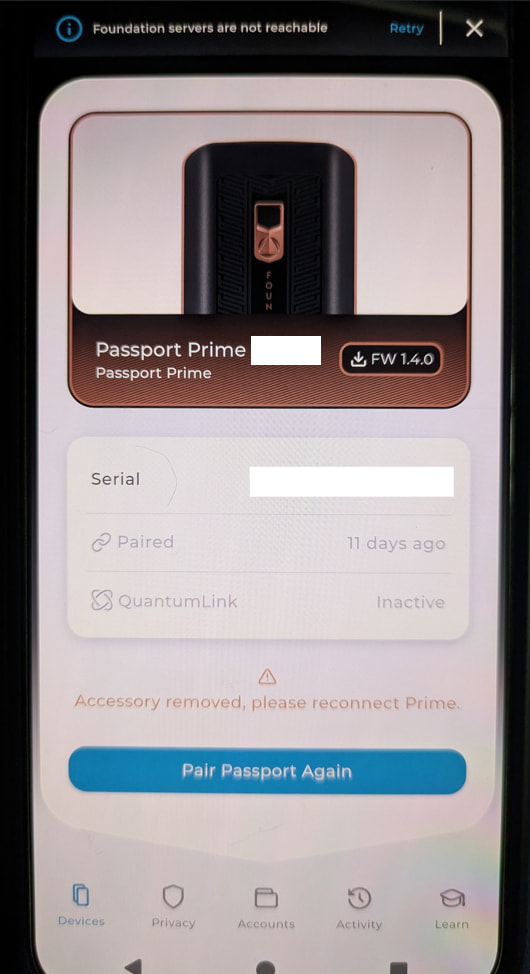

I’ve run into an issue with the 2FA app in passport prime. It appears that the Prime’s displayed 2FA codes have jumped ahead in time. A separate device displays codes that i have confirmed do work. Once those expire on that device, it then displays the set of codes that the Prime was showing just before that. So the prime codes do work, but only after the prime’s time has expired and is then displaying the next “future” code.
This error happens only after i opened Envoy after some time. Before opening Envoy the 2FA codes matched on separate devices. After opening Envoy i saw “Accessory removed, please reconnect Prime” And after that point the codes between devices did not match, and prime seemed to have jumped ahead.
I had seen this happen a couple weeks ago and I believe it does fix itself after reconnecting the prime. I wasn’t sure how to recreate the error, so I thought i would just wait and see if Envoy and Prime lost connection again after some time.
But why does the prime lose connection in the first place?
And why would a lost connection with envoy affect the codes in 2FA?
I haven’t reconnected it yet this time in case you need me to try something. Please advise

Thank you for the explanation, that makes sense. I didn’t notice that clock difference until now. Prime’s clock is about 37 seconds faster, currently. However what still confuses me is that Prime’s 2FA codes did not become unsynchronized until it tried to talk to Envoy again. This after a week or so just strictly operating as a lone 2FA device and not talking to Envoy.
Because i had seen this before i had confirmed that Prime was still in sync with my other 2FA device, and the codes did not jump ahead until I attempted to connect with Envoy again. I can’t comment on exactly when the clock itself changed because i did not observe that.
