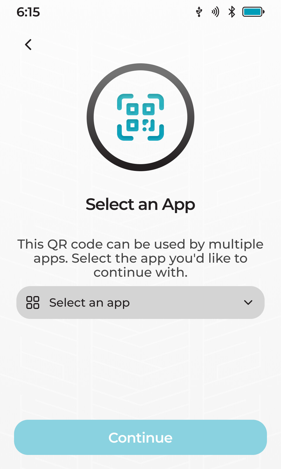

  • Yes! This is already in the works. We plan the home screen scanner to be able to digest more than just PSBTs. But also, if you install more than one app that can handle any given type of QR code, you would have to choose what app that is, and we also thought about that, quick snapshot below ;). It is planned for the near future, but cant really give you a timeline right now.
