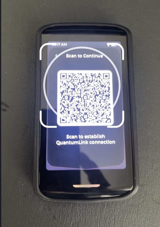

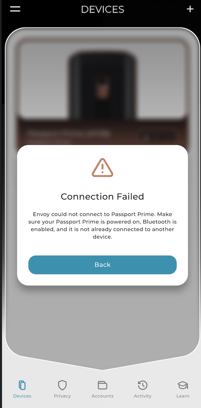

I upgraded to KeyOS 1.4.0 and created a local Settings & Data backup (settings-2026-08-16_17-50-03.tar). I then wiped the device specifically to test the recovery process, but I was unable to reconnect Prime to Envoy.

For the reconnection stuff on the beta firmware, please provide copies of your Envoy and Passport Prime logs.

Thanks for the logs. They show that Envoy was not accepting the Passport Prime pairing QR during these attempts. There also appears to be leftover Envoy state from before the wipe, so the cleanest next step is to remove that state and start a fresh device pairing.
  1. In Envoy, go to Devices. If Passport Prime is listed, tap it and remove it.
  2. Remove any existing Passport Prime entry from your phone:
    • iPhone: Go to Settings > Privacy & Security > Accessories and remove Passport Prime if listed.
    • Android: Go to Settings > Connected devices > Previously connected devices or Bluetooth, then forget Passport Prime if listed. The exact wording varies by phone.
  3. Force-close and reopen Envoy.
  4. Restart Passport Prime and ensure it shows a static QR code during the first part of onboarding
  5. Go to Devices, tap +, and add Passport Prime as a new device. Start with the initial setup QR and allow Envoy to advance automatically when Passport Prime switches to the animated QR.
If it still fails, please tell me exactly what each screen shows and export fresh Envoy logs immediately after the attempt.
Thanks! I followed those steps and was able to reconnect and restore successfully.
