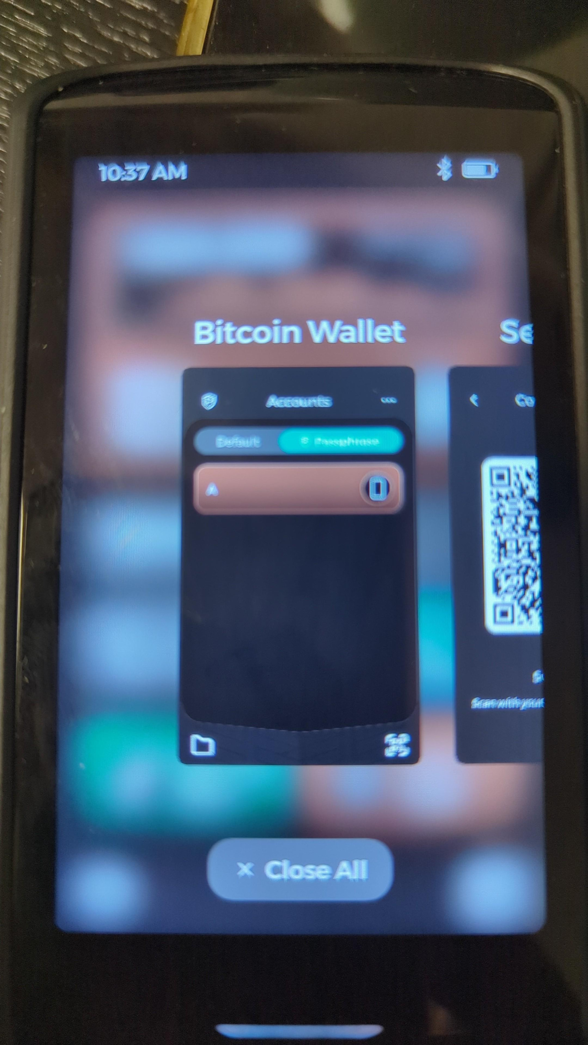

  1. Before continuing, let’s kill the Bitcoin Wallet app. Tap the home button on Passport Prime, and without lifting your finger, slide it up towards the screen. Kind of like you would do on an Android or iphone to kill any app. You should see something like the screen below. Tap Close All.
