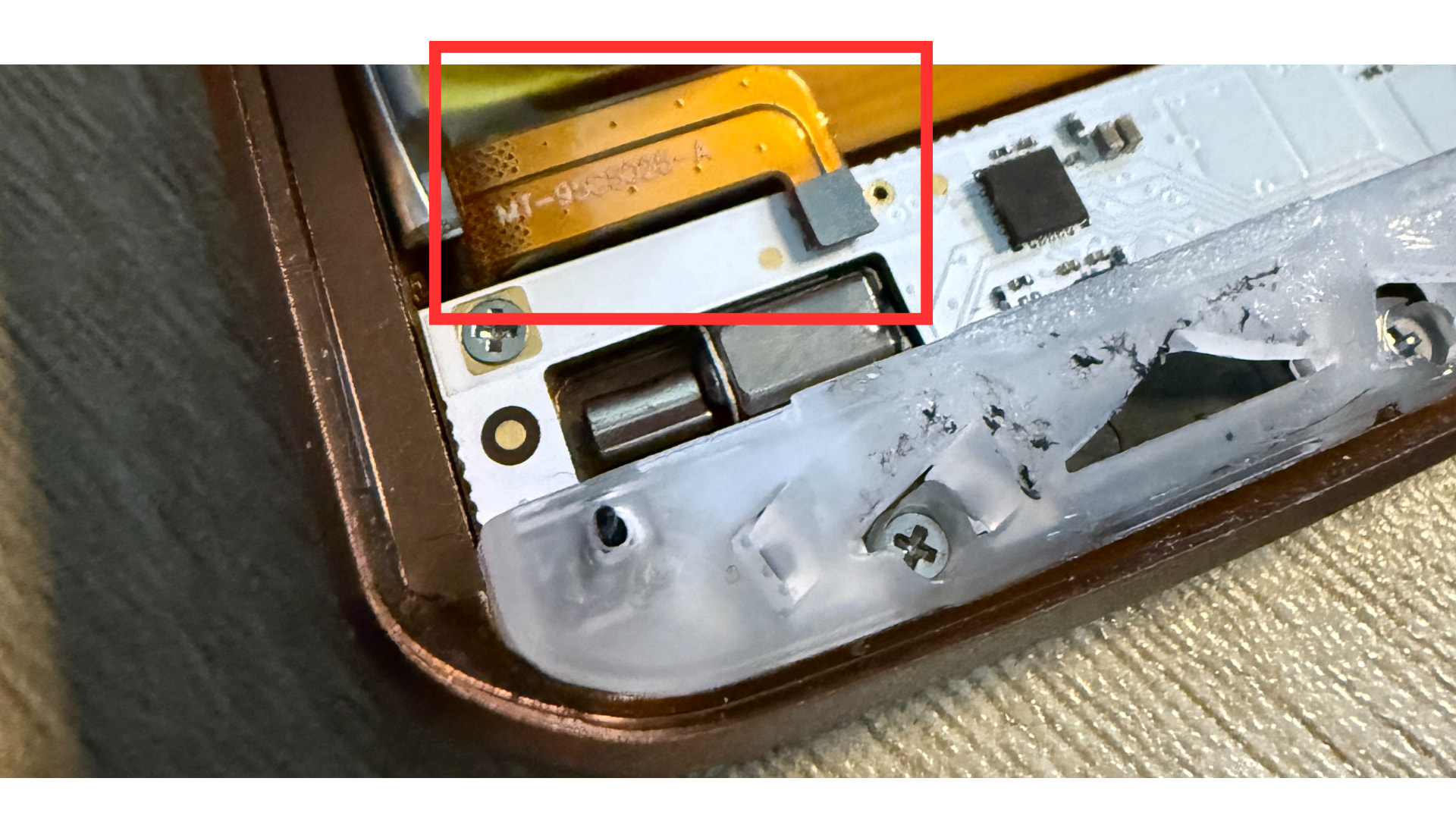

Hello,
Got a “developer unit” for experimenting bitcoin stuff on it.
Effectively at first, charging in all position didn’t work.
After unsealing it and clipping the copper connector to the circuit it works.
After putting it to charge, it works well and effectively there is a “tamper detected” yield by KeyOS.
Thumbing up this as I search for a moment why it wasn’t booting…
